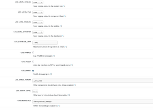

Logging a Filter in Debug
Check off Debug log. Choose the filters you want to watch divided by a vertical line (e.g. _zmfilter_2|_zmfilter_3). Choose a destination that is e.g. /var/log/zm/zmfilter_debug_+ (otherwise it will go to the home folder by default). Tail the logs in the filesystem. If you have other questions refer to the question marks on options/logging for each entry. After you are done, disable logging.
